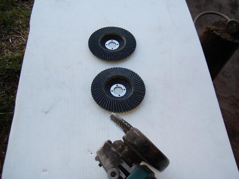

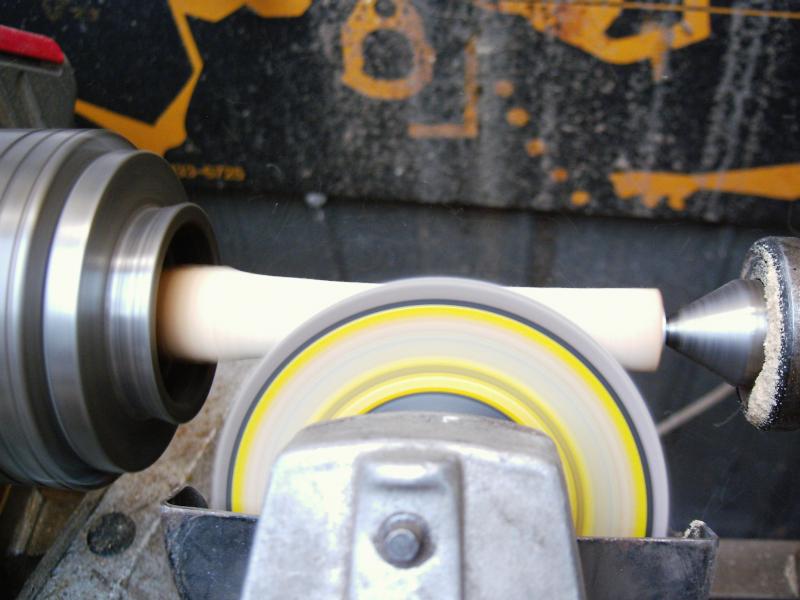

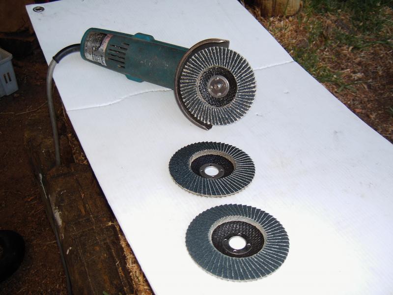

I would be given the "Flap" discs on a 4" grinder a go. I have said this countless times and I'm waiting for the first person to say that it didn't work...!:wink:
My suggestion is select 2 grits of the 4 normally available, I particularly like to use the 40 grit and the 80 grit, the other combination is the 60 and 120 grits.
Good idea to save the discs by taking the square corners on the bandsaw bu, after that no more cutting tools right to the stage of the hand sanding process. Use the courser grit to cut the blank right to the shaping point, then change the disc to a higher grit or get 2 inexpensive grinders and set on disc type on each one. Make your pen/barrel shaping with gentle passes voiding the bushes as much as possible, stop the lathe, clean the blank and look for any need of filling or CA, after that proceed as you would normally.
While the use of these Flap discs can make the bushings last less, the value of the bushings replacement compared with the time spent and blanks destroyed, just doesn't compare, regardless...!
This works for me and is working for a lot of other people that are now using this system. This is my story and I stick with it...!:biggrin:

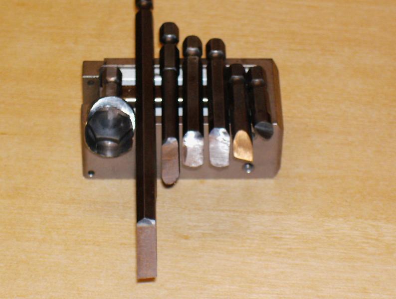

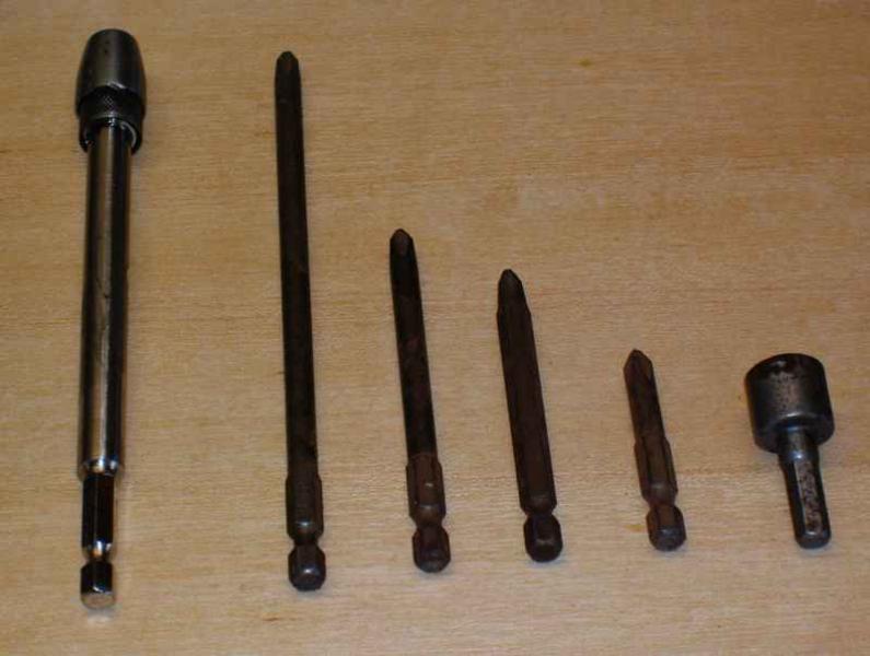

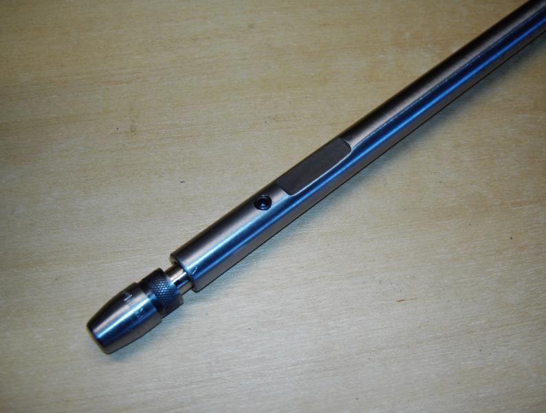

I remember that some of my first attempts at making a pen, were made using a self made tool, made out of a old trolley axle as the shaft, a bike hand grip as the handle, a half broken screw driver bits holder, some broken flat and Philips head screw driver bits, a old socket and a couple screws to keep it all together. Did it work...? absolutely...! anything that can be turn in a wood- lathe, I used it quite successfully. Can I turn anything I want with it...! you bet...!
Obviously, my turning tools variety in our days in a lot more "forgiving" and easier to work with, do I prefer some tools over others, I sure do and that is only normal and expected.
