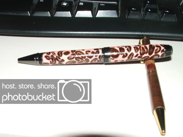

If want to make a blank like this:
would i use alumilite crystal clear or a different product
If you want to make a blank like that, then use the White Alumilite instead of the clear. That goes for any blank that you want to make completely opaque. You can add however much dye you want to get the colors you want and it will always be opaque.
