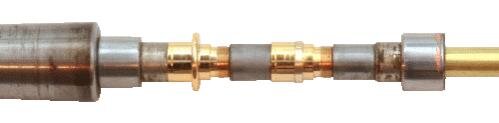

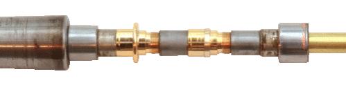

Since we're already discussing ways of modifying the coupler, here is my preference. Some brands of cigar pen coupler will simply slide onto a standard 1/4" mandrel. Some don't quite go on and need to be reamed with a letter "D" (preferred but 1/4" will work in a pinch) drill bit. Once on the mandrel, it is easy to turn the brass shoulder down with a scraper. The coupler doesn't get hot, and if you catch the brass dust on a paper towel, you can save it to use for infills later.
Regards,
Eric
