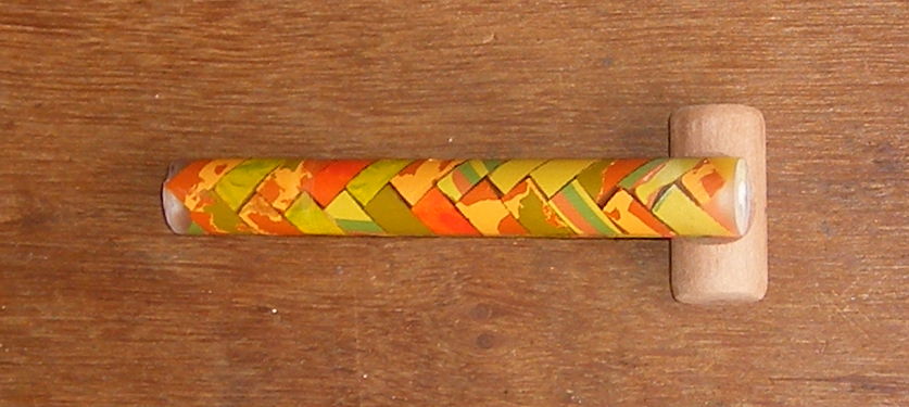

Here's a YouTube video of one of my first blanks. Here are some photos of others. Before turning:

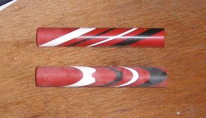

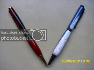

...and after turning and a little bit of mild sanding:

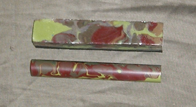

The leftmost one (in both photos) is the colour of the raw PR with no pigment added. In the tin, it's a lovely purple colour, but it goes green when it cures. I dunno what type it is. My next experiments will be more controlled because I'll know what I bought!!

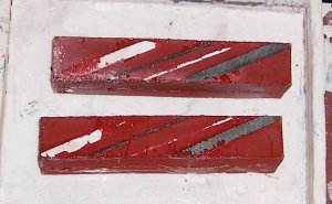

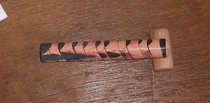

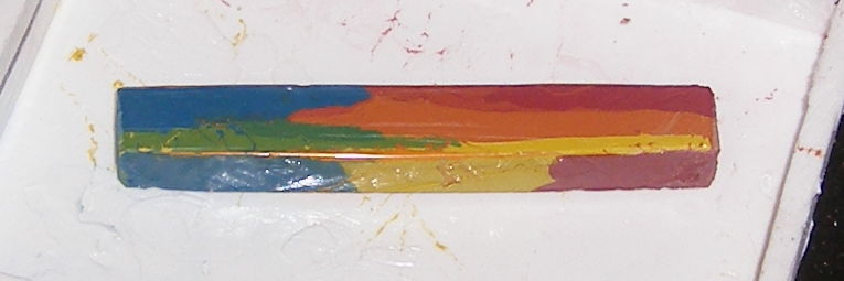

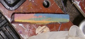

Here are a few more. I tried colouring the PR with enamel paint. It seems to have worked, but the cure time is longer. Black and red were the only proper PR pigments I had and, as you can see from the photo below, all the black pigmented resin fell to the bottom of the mould. Dunno why that happened, but I've got the proper pigment now so, again, more controlled next time. This is a nice before and after photo:
Because I use a metal turning lathe, I had to grind a special tool for turning the PR. I believe the result is now generating the requisite "ribbons":

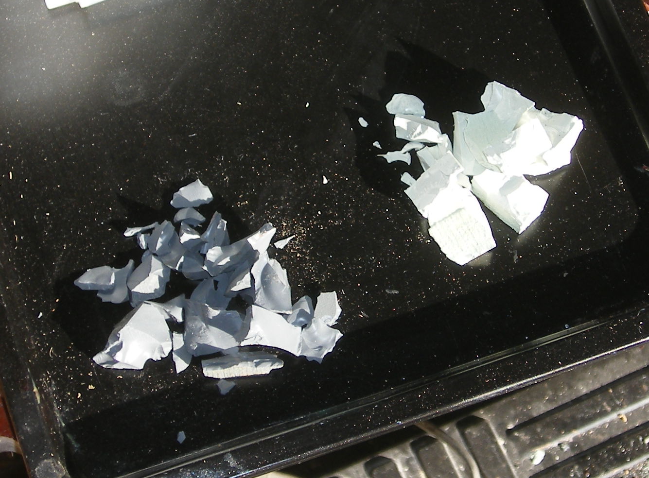

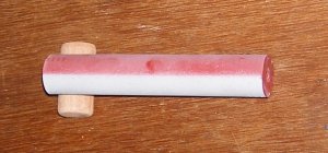

Speaking of fun, here are a couple of plain PR blanks. The plan is to smash them up then set the bits in another colour of PR (probably black) just to see what'll happen...

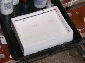

The assembled positive. Don't worry, I didn't glue it together. It's screwed. The glue line you see is two pieces of MDF because I accidentally cut it too narrow:
Scooshed it full of bathroom sealant:
And a few days later, here's the completed negative:
The walls are about 5mm thick, which is a little excessive, but it will certainly stand the test of time. Also, I neglected to cover the wood with clingfilm. That's OKay, it wasn't difficult to separate it, but you can see the saw tooth marks in the mould. I'm sure the clingfilm would have smoothed this a bit. Doesn't really matter - the blanks will go straight on the lathe anyway!

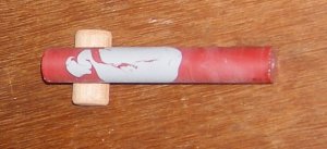

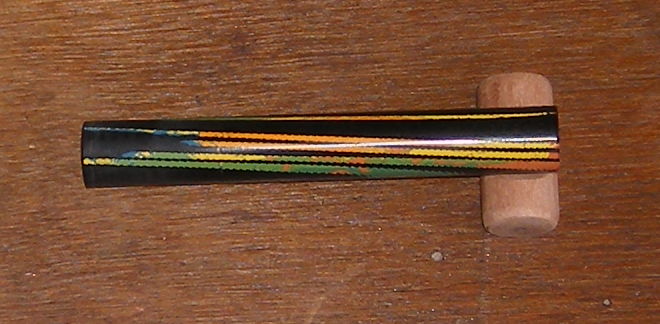

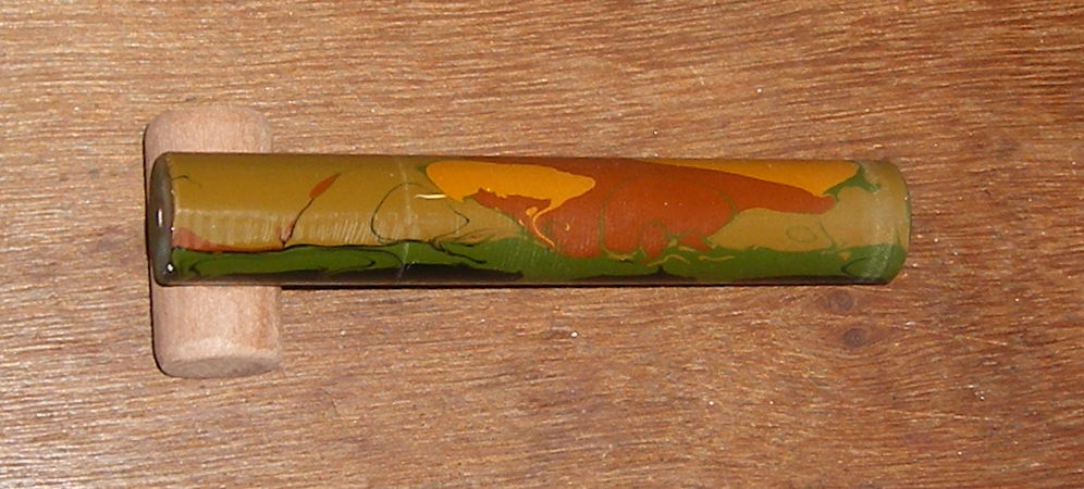

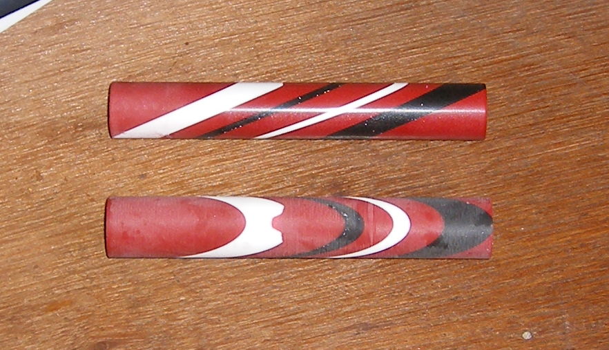

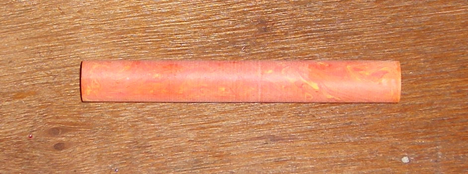

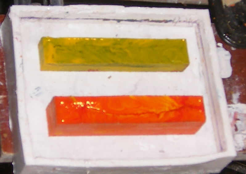

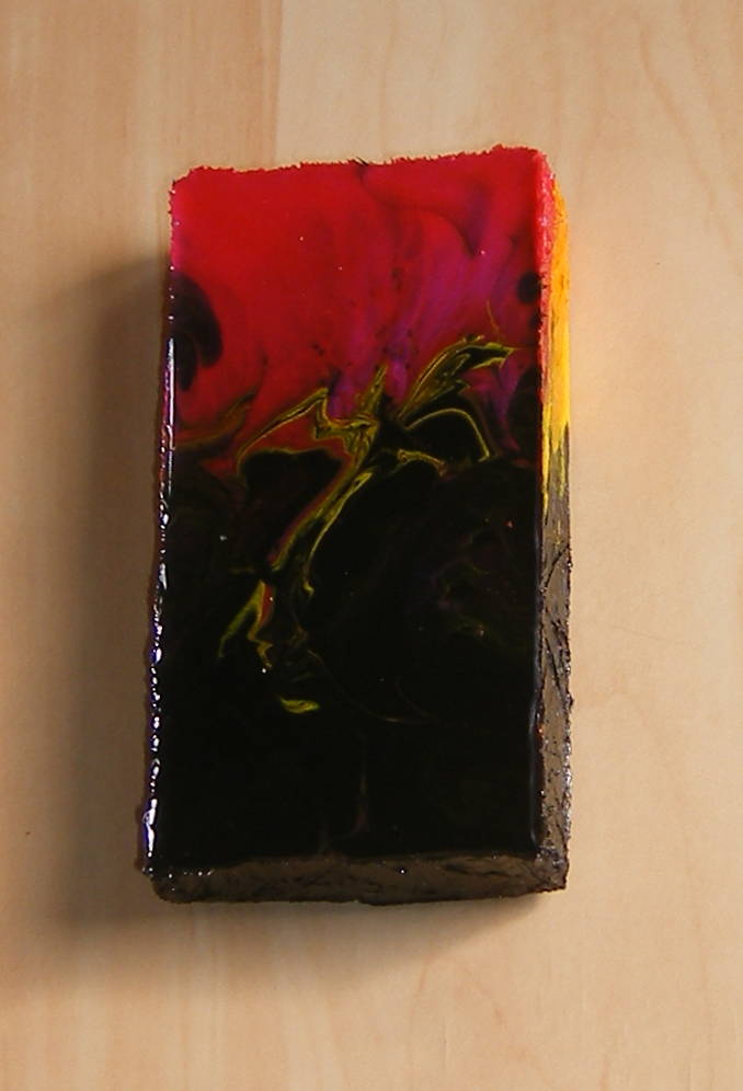

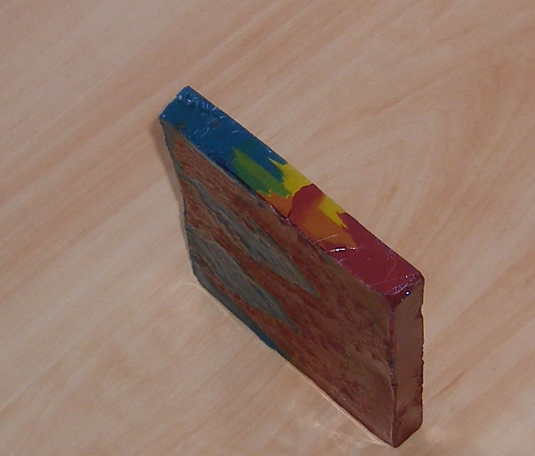

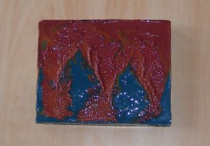

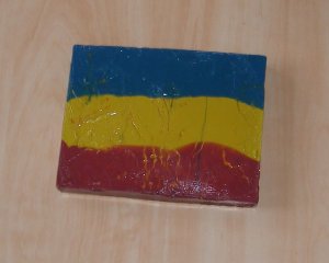

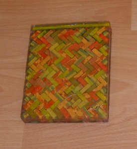

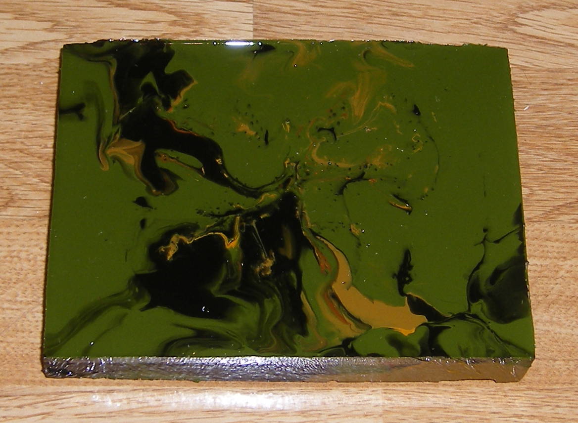

Now, I'm moving on from that first mould to a bigger one. I fancy making a big sheet of cast polyester resin which I can just slice up on the bandsaw. I reckon this is a big enough positive to make a mould which should yield 7 good blanks:
Ooooh. I haven't actually made any pens yet out of all these blanks. But making the blanks is sooooo much fun!!
