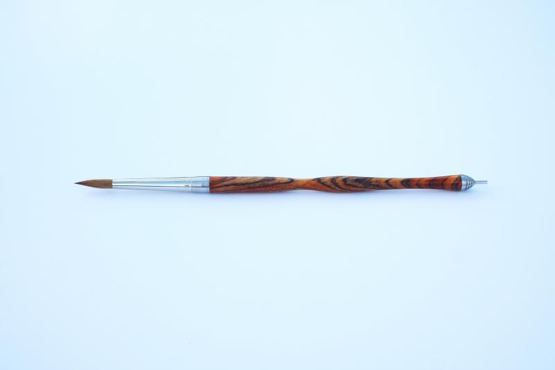

The real function the Tesla coil shaped brush end

]The imaginations went wild on this one, but the answers are slowing down so I thought I would answer the question before a few people go insane. I knew it was time to end this when a dentist had trouble with this. Lots of interesting answers though that were quite entertaining.
So here it is. Drum roll please.....

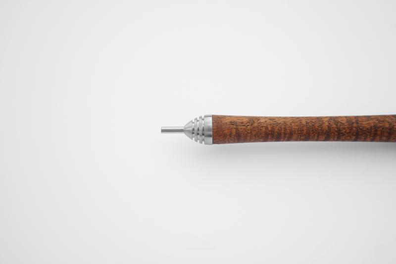

Porcelain Crowns and veneers are typically made by taking porcelain powder, wetting it to a thick slurry, and applying it with a brush to a die or metal coping. The porcelain is then touched with a tissue to remove the excess moisture from the porcelain. Many technicians will utilize another tool to create an even denser porcelain. That is what this tip replaces. Rather than have to put the brush down and grab another tool, this tip is used. It is placed against the die and gently moved back and forth to create a gentle vibration. This causes the porcelain particles to pack together even tighter and water comes to the surface of the porcelain, which is again gently blotted with a tissue. This action causes the porcelain to be denser, resulting in a stronger crown or veneer.
Now, I still have this really cool wood. Just look up Greenmountain Guys pics of the Curly pernambuco and Ebony burl. That is hard stuff to come by. I will give both pieces to the first person to figure out what a dental technician would use the tail end of this brush for. It has a definite function. In fact, the tesla coil has two functions, the end of it is about 6 mm of straight steel that performs another role. For all the marbles, what is that function. Good luck everyone!

This is not used by dentists, but by the dental lab technicians. They make the crowns, veneers and bridges for the dentists with those brushes. They are generally the true artists.
Removing the dies from the stone model?
I would use it to push up the tip of the dowel pin that protrudes from the metal sleeve used to hold and stabilize the die in the master model!

An addition:
Generally ceamists brushes have a straight bit at the brush end that usually holds a small ball bearing. Behing the brush it is hollow and it acts as a reservoir so that the tip of the brush is always moist, this is where the ball bearing resides. This allows correct dampening of the porcelain at all times and allows you to move it around.
If the brush is dry you end up placing a glob of porcelain on the crown or veneer.
Correct consistency is very important to any ceramist!
Andrew
A compression tool? That is, a "tip" to tightly "press" the ceramic slurry to shape the design. Heck, I know wood and don't know 'teeth'. Just hope to keep the few that I've got.:wink:
We have a winner!

Well I thought there had to be a lab technician in this group!
Congratulations! Seeing you are a lab technician, I will go one step further and give you a choice of the two pieces of wood or a brush made from either piece and a blank of the other wood. Let me know brush size, kolinsky sable of synthetic, wood type, and wether you would want a standard, push pin or condenser tail piece. If you would rather just take the wood, that would be fine as well. If you do refractory dies I will also throw in the worlds first dentin colored refractory material that I developed that has not yet been released to the public and a some uni-pins for making refractory dies, simply the best system in the world if I do say so myself.
