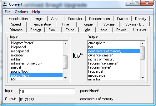

According to my handy conversion program:
  • 10 psi = 51.71493 cfm
  • 20 psi = 103.4299 cfm
  • 90 psi = 465.4344 cfm
Assuming that the paint pot you can get in the UK is similar to the Harbor Freight one that many of us use in the States, the compressor you describe is sufficient.
Um... psi is pounds per square inch (pressure) and cfm is cubic feet per minute (volume). Your conversion program must be magic!
Tom

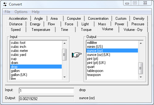

Damn it Jim. I am a pen turner. Not an engineer. :biggrin::biggrin::biggrin:
I thought cfm = centimeters of mercury.
But again how does this program figures out 1 drop = 0.00219292 oz.

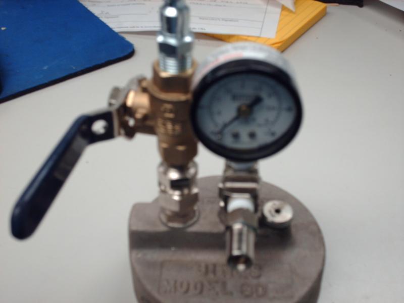

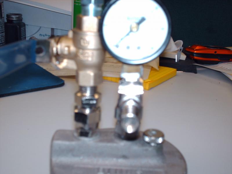

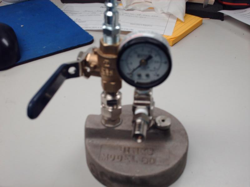

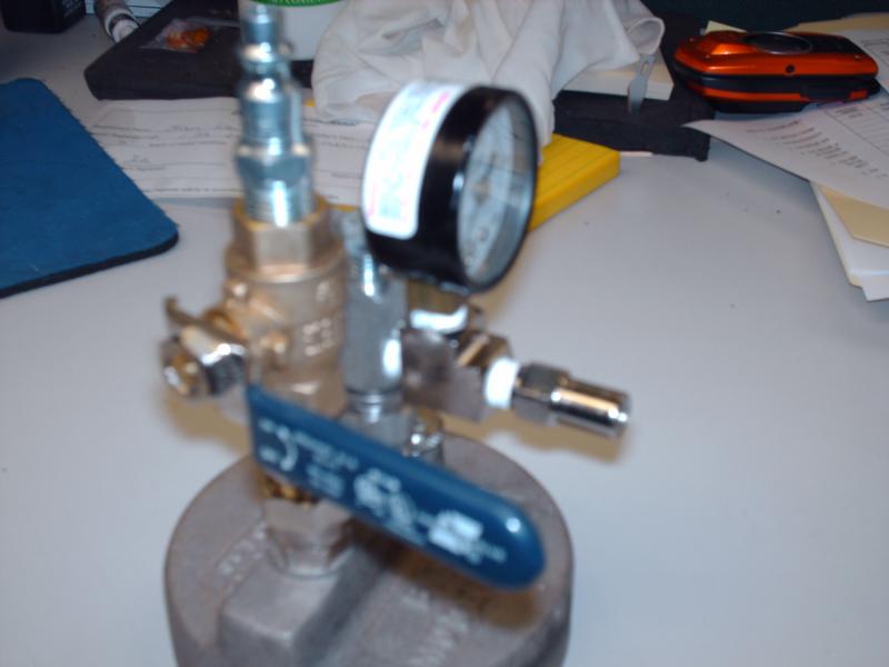

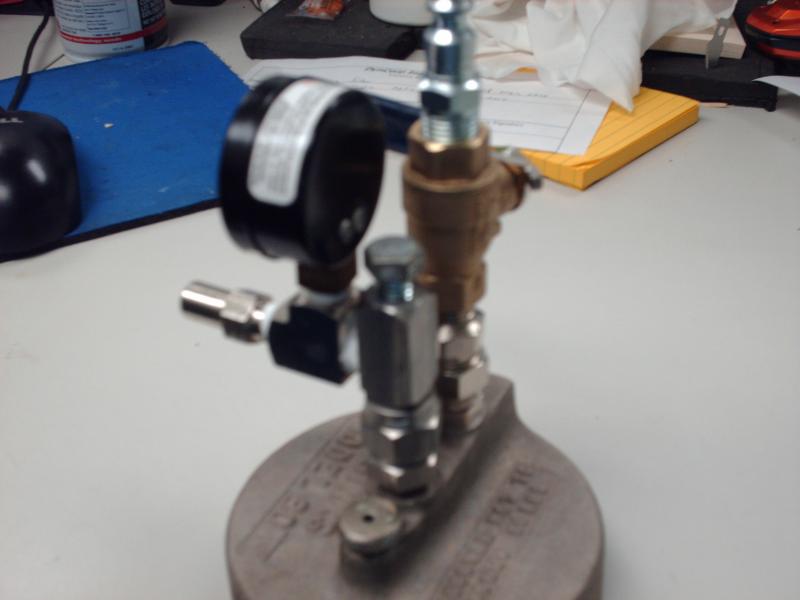

Here is a few pics of my smaller unit to give a idea...any questions just ask.
http://www.unc.edu/~rowlett/units/dictD.html
drop (gtt) [1]
a unit of volume used in pharmacy. Traditionally the drop was another name for a minim, a unit of volume equal to 1/60 fluid dram or 1/480 fluid ounce (about 0.0616 milliliter in the U.S., 0.0592 milliliter in Britain). Now that prescriptions are written in metric units, the pharmacist's drop is equal to exactly 0.05 milliliter (20 drops/ml). In hospitals, intravenous tubing is used to deliver medication in drops of various sizes ranging from 10 drops/ml to 60 drops/ml. The traditional abbreviation is from the Latin gutta, drop. Originally, gt was the symbol for a single drop, with gtt being the plural.
However none of the numbers come up to the one in your conversion.
