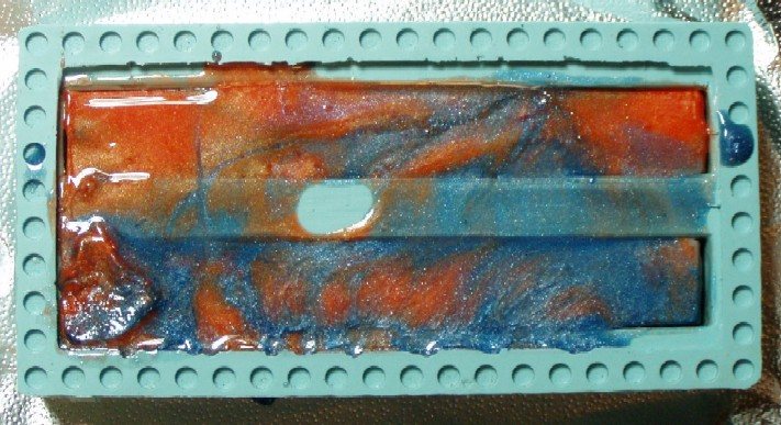

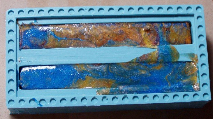

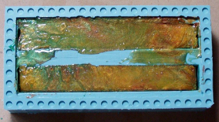

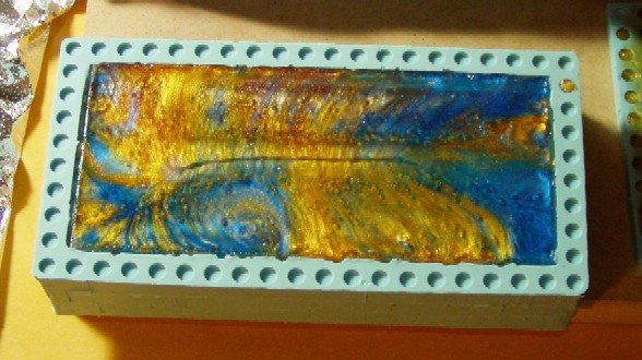

I tried Grub32's mixing method to inaugurate some new molds. I like it alot.
Here is the first cast of new mold #1.

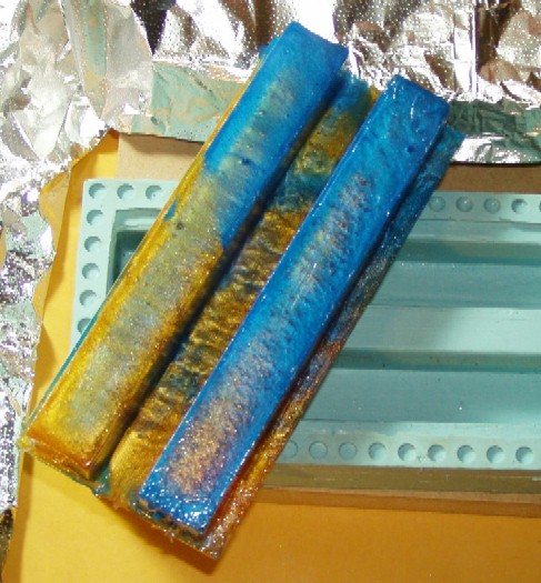

This is the demold.
The cavities are .76 x .76 x 5.5 inches, and each cavitity holds 2oz of resin. I poured a little extra thinking I would loose some in the 4 color cups but suprise! I didn't loose nearly as much as I expected.
Silmar 41, 4dps MEKp (it was raining), preheated the mold with a heat gun.

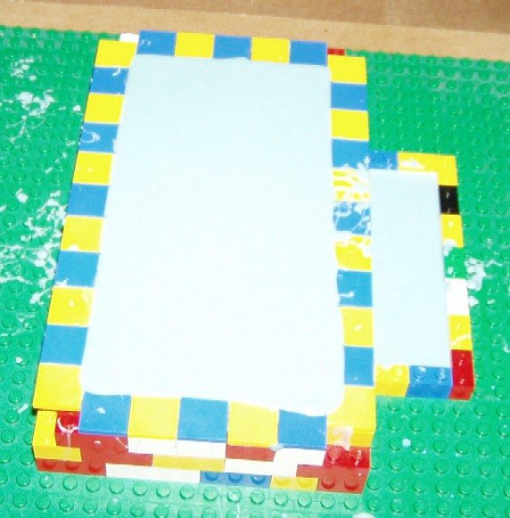

The cane forms were made from 3/4" "square" dowels cut to 5-1/2" lengths that I surfaced to seal with Silmar 249 suncuring resin for surfboards. I mounted them on a bed of block caps. Built a 3 block high box with the cappers(which I think are Mega-Blocks). Bought some silicone, made up 5 of these molds.
Sorry I didn't take many pictures in process.
If the square dowel is available in the size one wants then anyone can make any size they want.;)
When I made mine, I just used some pen blanks that were the same size as I wanted to make. Mine were wooden ones that had a wax coating, but I could have used PR ones easy enough.
