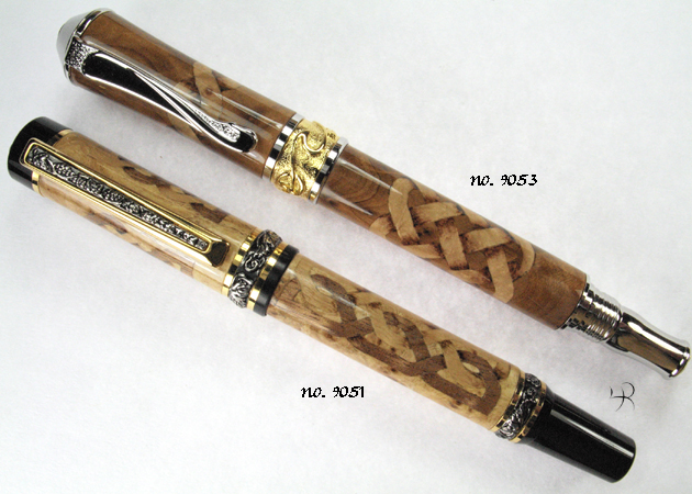

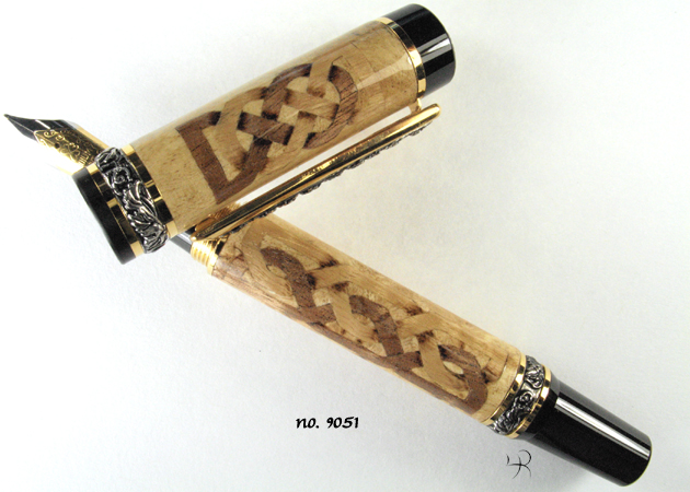

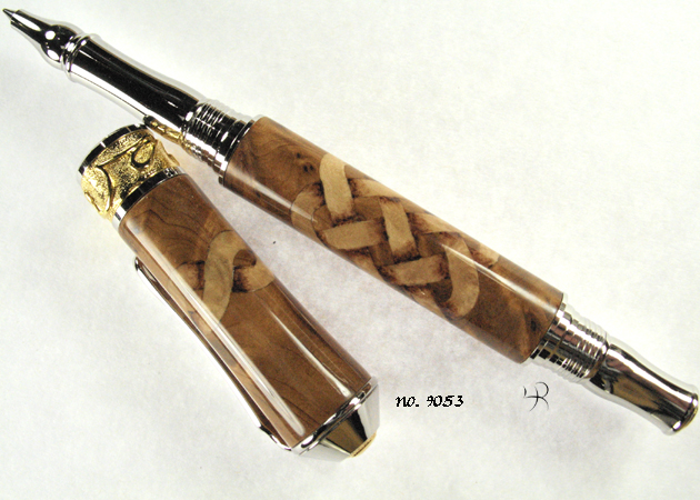

In a true Celtic Knot the elements always alternate over/under as they cross one another. Never over twice in a row, never under twice in a row. This is impossible to replicate using segmentation. However with actual inlays:
Pen #9051 - Cambridge Fountain Pen - Elm Burl barrels - 26 pieces of inlay in Anigre and Sapele Pomele.

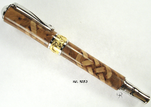

Pen #9053 - Rodium Nouveau Spectre Rollerball - Thuya Burl - 28 pieces of inlay in Maple Burl.

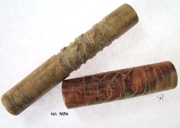

As for the how to; there is no secret tool or method. It is just old fashion inlay techniques. You dig a hole and fill it up with a piece of wood, repeat till done. I size my artwork to the pen diameter, carefully scribe the outlines on the blank then cut the cavities. After that I cut and fit individual pieces to fit.
Here's a photo of one that's on my bench at the moment. One blank has the cavities cut ready for inlays and the other is only scribed. Hope this helps.

I do quite a bit of marquetry work, and was wondering if you sand shade the shadows, or if you use a woodburning tool to create the shadows. I do a ton of sand shading when doing the marquetry stuff, but wasnt sure if that would work for you in this application. Inquiring minds would like to know!

I tried sand but it wasn't too successful. Lost the effect in final fitting to pen contour. Resorted to the old carving feathers on birds tricks with the pyrographic pen.
