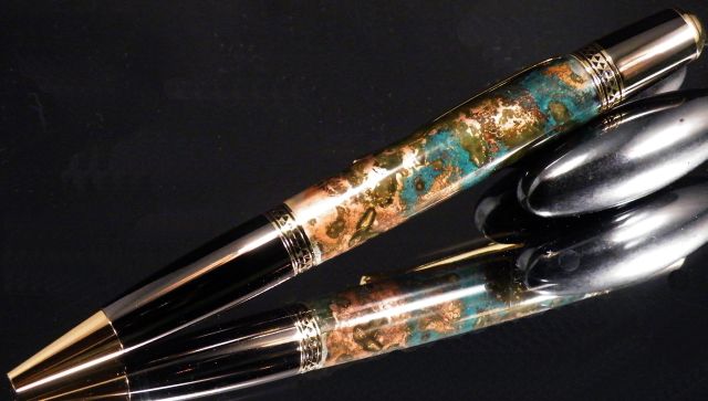

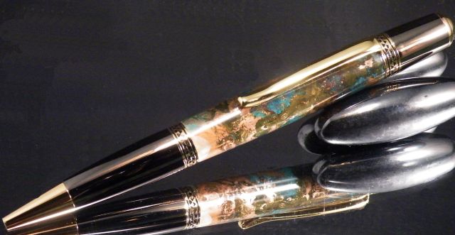

This is a Tapa Pacifica with a Azul Copper blank . Mark Ligget had asked about a blank made from Azul Copper veneer/sheet , I looked at the picture of the veneer he had and just loved the colors so I ordered some to try and make some blanks from . This is the result . I cut a piece of the veneer and glued it to a Pacifica tube then cast it in some PR , I was not happy with the look after it came out of the mold but after I turned it I was very surprised with the results . I think it came out great .
As always , comments are welcome .

Thanks .
The veneer is actually a copper sheet .005 thick , not sure why they call it veneer .
I cut a piece of the sheet a little bigger then the brass tube and formed it around a slightly smaller tube then slid it over the sierra tube and used a hobby knife to trim to the exact diameter of the tube , then I used some spray glue to adhere the veneer to the tube and let it sit overnight to let let the glue fully cure . Then I cast it in PR and turned as a regular PR blank .
There is a seam but I tried to keep it as tight as I could then hid it under the clip but it is visible a little .

Thanks for the kind words everybody . This pen came out much better then I thought it would . When I first cast it it looked like all the blue are gone away and it really didn't look like it was even worth turning but I have learned at least one thing making pens , the worst looking blanks sometimes make the greatest looking pens , and this is one of those times . I got a great balance of colors and patterns and I am very happy .
As I said there is a seam but a little creative photography made it disapear into the shine line (by accident ....Really!!!) . I managed to keep the seam very tight by very carefully trimming the veneer , but it is there and can be seen up close , the clip covered most of it though .
