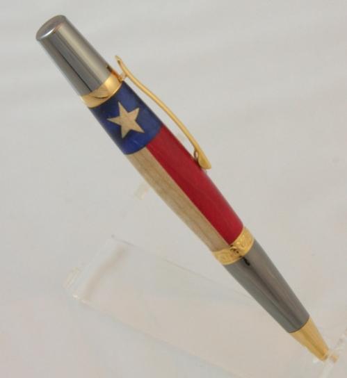

Well, I just realized, the Texas flag is upside down (red on top). Any suggestions (besides disassembly and fireplace?)?

What was it, a 4 piece kit you had to assemble? If that is the case, what did you use to glue it together? On the assumption that is is 4 seperate pieces, I am going to say very carefully skew and sand your finish off. Punch the kit off. turn your oven on as low as it will go. Place the blank on some tinfoil in the oven. If it is assembled with wood glue, CA glue or epoxy, the glue will soften. Put some gloves on of course. Grab the blue end and try and pull it off the tube. Even if it doesn't come off, if you can get it to spin, spin it 180, to the back side of the pen. The pen will cool quick and the glue will re-harden fast, so you need to work quick. Or maybe you have not choice but to pull that right off and flip it so the skinnier side is against the red/white. Then you will have to re-spin the pen to be flat with no curving shape..possibly even have to spin a small dipped in area where the star area meets the flag area. That's all I can think of to try and salvage it. Othewise, flip the clip. A star is a star, and can't be upside down really..it's just a visual perception that a single point must go up, but in space, god could care less.
I am not following this thread. Are you saying the star should be where the nib is??? I can't see how it is backwords?? Didn't we go through this with Constants flag pen kit and I forgot the outcome of that one. But I think it was said it really doesn't matter because of the way you turn the pen. Need a better picture to see the problem. :confused:
I also don't understand the problem. Isn't it a round pen? It will be correct on the other side, won't it?
On a Texas flag, the white stripe is on the top, the red on the bottom and the 5 point star has one point at the top, on both sides. In this pen the red stripe is on the top, or the star is upside down. I'm gonna try Jeff's suggestion. Its CA glued.

Keith, we can excuse jttheclockman for not knowing any better since he probably isn't familiar with our flag but being a Texan you should see the problem. The flag is white over red and regardless how you rotate the pen the star will always be upside down with the "legs" of the star pointing up.
Tom, let us know if the ungluing works.
OK I went and googled the flag and see the problem now. Will be interesting to read the outcome of this. Is there another flag with the opposite colors that you could send it to????:biggrin:
JEFF POWELL.... YOU ARE A ROCK-STAR!!!
Went out and studied for a while. Happens that the LOML has a soldering iron in her stained glass stuff that fits pretty well inside the brass tube....
Put it in there and within 10 seconds there was a sizzling sound and a little smoke. Dumped it on the table, grabbed some gloves and spun the blue part off!!!
Cleaned the tube on the lathe and the blue part with a little sandpaper wrapped around a smaller tube. Blue part is exceedingly thin with no tube inside it. Glued it back on....correctly this time (180 degree rotation on the tube from where it was before). It's drying now. I have to leave the country tomorrow before dawn, so it'll be 2 weeks before I can post pictures.

We put one of our laser kits together wrong and it had some gaps. So we put it in a jar of acetone for about a week it came apart just fine. After all the pieces were good and dry we reassembled and finished.

I was thinking that maybe the star was one piece that went all the way through the blank. If that was the case, the pen (and the star) would be "right side up" if turned to the other side.

Glad it worked out for you Tom. Kinda goes back to the old paint/glue problems a lot of people have with tubes in acrylics. If the barrel trimmer rod spins too tight and too long in the tube, it generates heat which softens the glue which causes the tube to spin in the blank. I guess now you can stay in Texas. Have fun on your trip.
I think this is why Constant didn't make a "through star".. It would always be wrong on one side.

On a serious note, I do appreciate the hint about the soldering iron to dismantle CA glueups.
Steve
I made it back to the Lone Star state last night, complete with the "revenge". Heading back to the land of Montezuma tomorrow. Checked the star and it is still correct!
