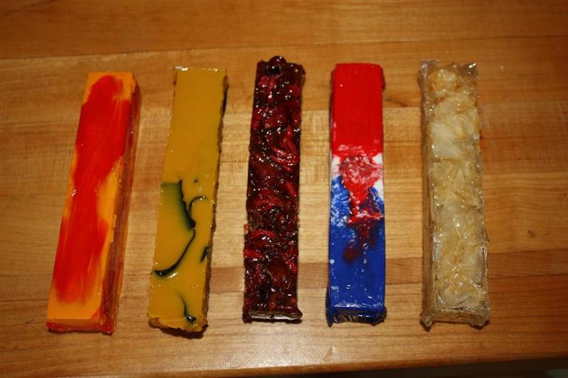

I have more but this is a few of them.
#1 & 4 are standard color mix castings
#2 is a color casting with black EP strips in it
#3 & 5 are clear castings of flowers
The wife has been working on more. I just need to start turning!!!

black EP strings? what is that? epoxy? are you casting with PR? i would love to know how you put those black strings in there. Looks like a professional blank you would buy at the store. The yellow and black combo like that remind me of Bruce Lee.
Number 4 is really cool too. Should be a very Patriotic pen!
Nice castings! how do the flowers turn?

You mix the color that you desire for your ribbons and put hardener in your PR. Then pour a small coat on an old glass picture frame to make a very thin cast. Once the cast hardens, you can cut it up and form it the way that you desire and then just cast it in another color.
Being in the military, my wife likes to make the patriotic stuff. Especially with Independence day coming up.....
Haven't turned any of the flowers as of yet. The lightest one didn't have enough petals in it and so I don't think it is going to turn out very good. I will let you know when I am done....
