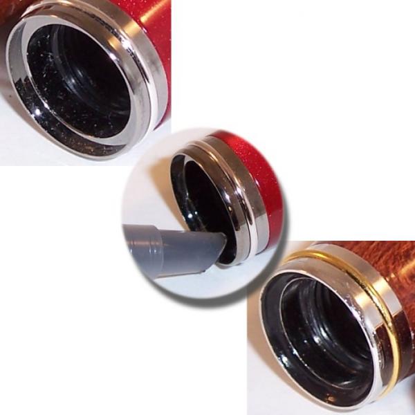

The purpose of this post is to share something I have dont that I feel is noteworthy, NOT to start a debate over which kit is best or which is the worst or who has experienced this problem or who hasn't.
A known issue with several types of capped pens is that they often come loose in the pocket or in the case of fountain pens, they come loose then whatever fabric comes in contact with the nib changes color! :)
A commanly accepted "fix" was to use an 0-ring but after spending several months trying to find just the right o-rings to fit the caps I use, I finally gave up searching and looked at an alternative solution. I also thought the o-rings made the pens look cheesy and cheap!
My solution was a bead of silicone that won't fall out, is barely noticable if noticable at all and works better than an o-ring, in my opinion.
What I did was to get a tube of black silicone adhesive sealant and run a thin bead all the way around the inside of the cap (look closely at the photo below) and letting it completely cure for at least 24 hours before mating the lower pen together. After running the bead around I got a cotton swab and cleaned any "squish out" from the inside of the barrel. Then with a moistened (saliva) finger lightly ran the finger around the bead to give it a smooth appearance. Finally I removed any "squish out" from the outside of the cap.
I like the results so far, the seals give me just the right amount of "grip". What you see below are my guinee pigs. The Emperor on the right is my daily carry around pen and was the first to be done last week and so far is working GREAT. The others are on my desk but not used constantly but so far all are closing snugly with no signs of the seals flatenning out.
So..... if you are tired of your caps unscrewing themselves, grab a tube of silicone and give it a try!

I just had a discussion about this with a friend and something was brought up so I wanted to clarify.
In "REAL LIFE" the silicone isn't even noticable unless one is looking for it. When I took the above photo I had the tent lights on and the camera flash as well so we could see "inside" the cap.
Under normal lighting with the cap in hand you don't even notice the ring as it blends in with the black plastic threads.
So now you have the whole story! :biggrin:

Additional idea -
I've used the black silicone for years to seal up molds for concrete countertops. I use brand name (GE or equal) full silicone caulk. Latex or blends would not be good.
One of the tricks that I've learned is to use masking tape or something similar to reduce the smeared sealant and make the cleanup easier. Basic idea is to mask off the balance of your workpiece and only leave the area to be sealed exposed. Trust me, this works better than smear and wipe methods - this stuff is really gooey.
I think this could be applied to the outside/barrel of the pen easily. Inside the tube may not be as critical, but another approach might be to make a plug to fit in the pen barrel, sizing it to keep the goo where you want it.

I don't know if the brand makes a lot of difference or not but I grabbed a tube of Permatex Black Silicone adhesive sealant.
Oddly enough I was at the local Ace hardware where I was promised the correct o-rings had finally arrived. They hadn't but that is where I decided to try the silicone.
I figure that one 8oz tube is good for about 6,324 pens, so I'm set for a while! :)

Jerry, You are correct, there is a space between the edge of the cap and the inner barrel where the threads actually start. This is the area where you have metal to metal contact when the pen halves are mated. Since the metal to metal contact provides no gripping effect the pens unscrew easily.
I filled that gap with silicone and now you have metal to silicone to metal which gives you a gripping seal.
I took another photo to show the before and after look.

Mike, The addition of the sealant does change the alignment of the cap when screwed on. It's not much but when crafting a pen I would do the silicone first, let it set for 24 hours then align the upper and lower body then press the parts together.
For those pens that are a bit "over aligned" already, you are correct, this might solve the problem.

Thanks George, I'm going to try it on one today. I made a Jr Statesman from a really figured piece of Mesquite and despite very careful "eyeballing' a very distinct area of grain is off just a lil. This may fix that and yeah that was my thoughts to do the silicone first ...then assemble

The silicone can be messy to clean up,it seems to want to stick to everything.

Maybe I'm just lucky but I find that it's about a two minute job. With the nozzle cut a hair wider than the upper and lower metal surfaces, the bead is applied in one swoop then running a cotton swab around the inside grabs 100% of the residue then again on the outside. If you wait for it to dry you will find it a lot harder to remove.
I got an email this morning asking about what color silicone I used, black or clear. I hadn't really thought of using clear since the black looks like it belongs, being adjacent to the black delrin threads.
Has anyone tried this using clear silicone, if so is it hard to see or do you think it looks better?
And while I'm posting this, it's been over a month now so as an update to those wanting me to keep them informed. Using a 10x loup I can see no wear whatsoever on the emperor I carry everyday or on any of the Jr Gents I have in my desk carosel. So far so good!
