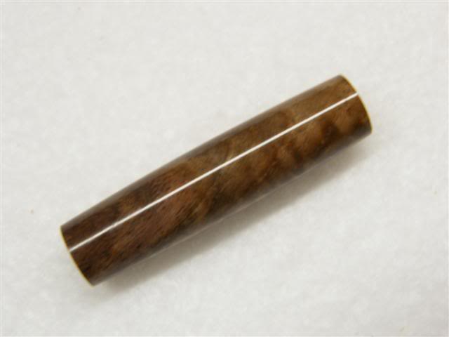

You wanted to see the blank with the lathe stopped.
I have not been in my shop all day so have not turned it into a pen yet with the hardware but when you mentioned that you wanted to see it with the lathe stopped I went out and took a picture of the blank.
To be perfectly honest , I took the picture exactly as I took it off the lathe after the three coats as shown in the video. I took it off the lathe to where I had better lighting for a photo. I would normally have gone to 4 to 6 coats but didn't want to keep repeating it in the video
I applied no wax for the photo and to be totally honest the picture is untouched and directly off my camera without putting it through any photo editing software whatsoever. .

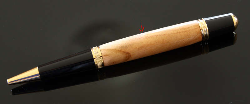

Anyway, after months of struggling to get an easy CA finishing without using accelerator, I give this a try after watching it yesterday. I did a very rushed job, and had a couple of issues, but all I can say is, if it's this easy and just as durable, then plain CA goes out the window for me. Was as easy as a friction finish - and seems to have given a great result. No more sanding off more than I put on, no bits of towel stuck to the blank, much less consumable wastage, and no waiting for drying time!
My only issue, as indicated in the attached image of the first one I tried on some white peach, was I developed a flat (i.e. non-glossy) spot half way through in the middle of the blank. It was slightly sticky too, although that went away in subsequent coats, but the spot is still there. Would this be because I didn't get one coating set properly before putting another on?
Maybe using accelerator with normal CA is just as good, but I don't like the stuff, and it's not cheap, compared to BLO. Are there any drawbacks anyone knows of using this method? It sure seems a winner to me.
