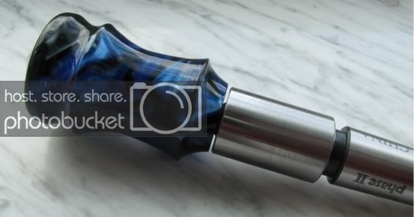

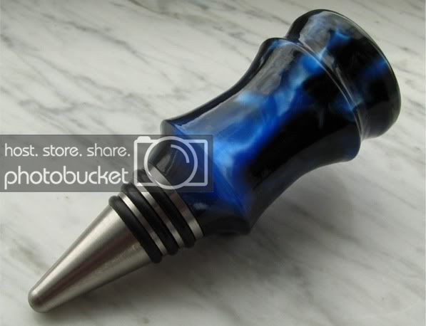

I turned a stopper from the last buy on Ruth's mandrel. I used Paul Huffman's vise, a 1" forstner bit, and a 5/16" (oops, originally said I used 3/8" bit) drill bit on this one. Ruth recommends a 23/64" drill bit when the mandrel is used. I would have to agree as it must have taken me several minutes to get the block threaded when I used the 5/16" bit. I used the forstner bit so that the base would be completely flat and sit perfect against the stopper base. If you don't have a 23/64 bit then I would recommend a separate tap that you may already have. This is te tap with the stopper on it. The gap is normally not there and would have been really tight to remove had i screwed it all the way on.
Once turned, I popped the mandrel out of the lathe, installed my Beall setup and used the mandrel as a handle. A longer handle may be a bit more comfortable, especially if you have a two lathe setup where the mandrel may stay in the first lathe. For those with a small shop or budget, the mandrel works well.
In addition, the stopper does not seem to seal tight. However, I filled several bottles and layed them down, turned the upside down, shook them, and did just about anything else i could do to try and get liquid to come out. I asked Ruth about the percieved looseness and this was the reply I got.
First you do not want the stopper to fit so tight that you have to really pull hard to get it out, all you need it to do is seal the wine. If the wine does not leak out, that's the best you can say about any stopper. Also no stopper, metal, silicone or cork is going fit every single type of bottle on the market. If a glass bottle is not absolutely round, a perfectly round metal stopper (any metal stopper) will not fit tight BUT it will seal the wine to any wine drinkers satisfaction. Are you using the same bottle? The same brand? Try different bottles and different brands.
There is only one reason to ever lay the bottle on its side and that is if it doesn't fit in the fridge standing up. Every single wine drinker I know, keeps the bottle on the door and there is never a problem. There seems to be this "wine lore" about a bottle laying on its side, that came from keeping the cork from drying out. A number of wineries in CA, where I sent my stoppers to be critiqued before they were put on the market, were impressed and satisfied with the design and fit.
I have no doubt these will work perfect with the majority of bottles out there.

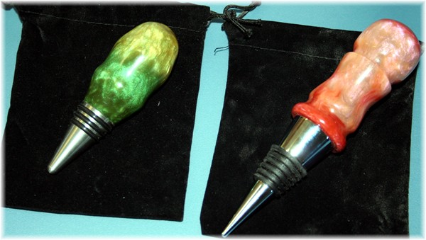

I thought this picture might bring some clarity on the difference between a standard stopper and the stainless ones in this group buy:

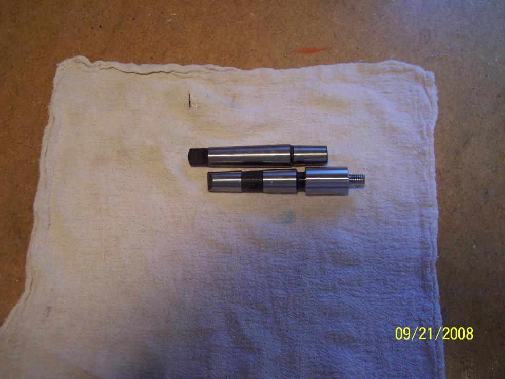

I just tried to use Ruth's Stainless mandrel in my Delta Midi Lathe. The mandrel is too long for the Headstock. It needs to have 1/4-3/8 of an inch removed before it will fit and seat in the head stock. Not a big problem either take a hacksaw to it or take it a machine shop and have them remove it. 9/20 3:30 pm I went out in the shop and modified with a hacksaw, worked fine it now fits pictures attached. Ruth's mandrel is the bottom of the two to show the difference in the two shafts.
