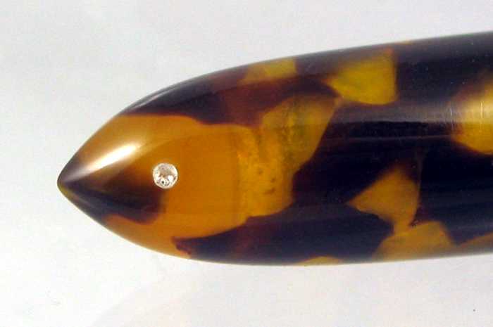

Kitless

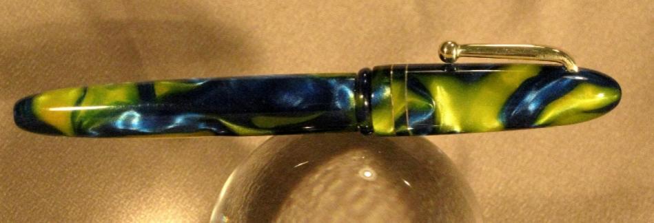

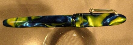

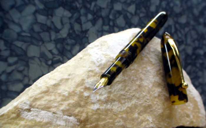

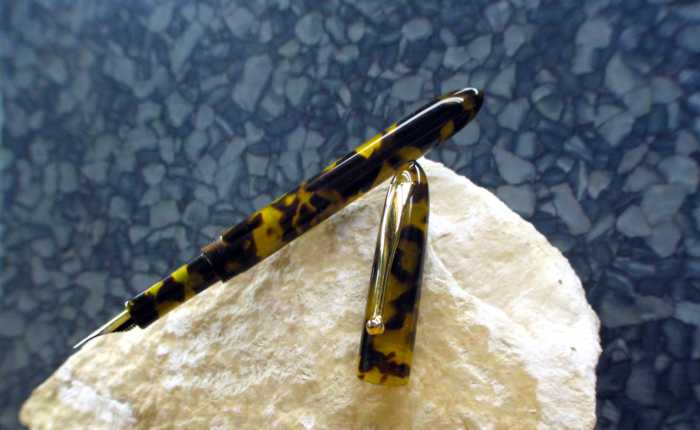

Here is a fountain pen. All parts made by me except the nib. 4 start thread done on the mill. Two views of pen and one of small diamond on the cap. Made from tortoise shell acrylic.

Not a problem Bob . It is a beautiful Kitless fountain pen , I like the Diamond accent and the overall shape .
Thanks for posting it it shows where this kind of challenge can lead to .

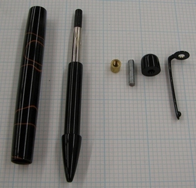

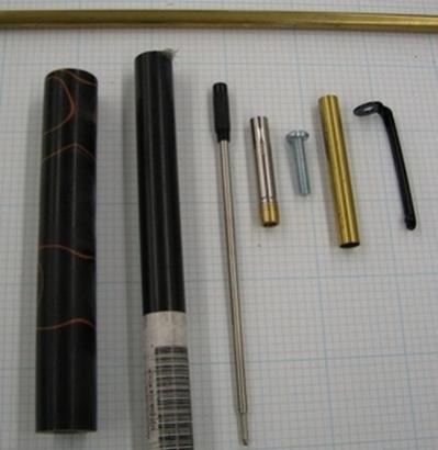

I posted photos in the original thread but I guess I was too fast:wink:! I just read where all photos are to go here so here they are again....

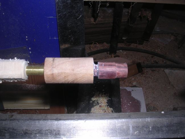

This is what I started with....blank, Delrin, refill, tranny, 8X32 screw, one tube, Euro clip and some brass rod.
Here's the parts I made
Here's the results. This is my first "kitless" attempt and all in all I'm pleased with it.

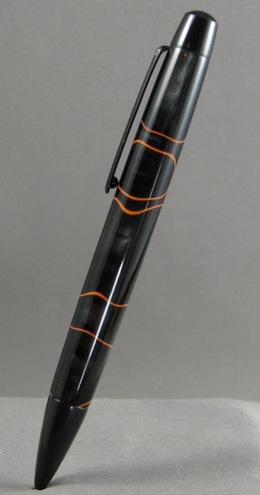

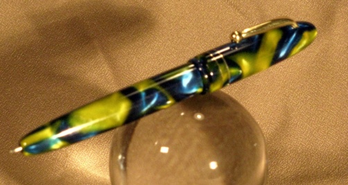

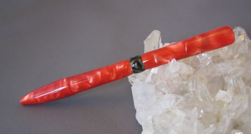

Thought I would give this a try.This was my first kitless pen,and first closed end.I think it turned out o.k. not real sure I like the shape.What do you guys think?I learned a lot by doing this,mainly what not to do.:smile:All it has from a kit is the tubes(modified),refill and transmission.Oh the blank is Pomegranate acrylic and the center band is serpent rod.I did this without a closed end mandrel.
Superb Ronald .
Love the blank and the CB gives a nice contrast , I like the shape but I think the lower barrel could use a little diet , the upper closed end barrel is perfect .
Overall an excellent example of a kitless slimline .
These pens are worth every second that it takes to figure out the techniques of turning them . :good::good::good:
I thought that about the lower barrel also.I did'nt want it too thin and ended up leaving it a bit thicker than I wanted.It does have a nice feel to it though.
I did the closed end and the nib end on a wine bottle stopper mandrel.I drilled the blanks with the bit for the bottle stopper mandrel,turned and finished the blanks,then redrilled to tube size after turning.I also had enough room on the mandrel to get one slimline bushing.
Great idea Ronald . I never thought about using a Bottle Stopper mandrel , then redrilling to final size after turning ... thanks

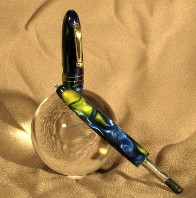

Hello to all, here is my attempt. This is the first time posting with pictures and using the camera, I hope they aren't too blurry! Anyway my goal was to make a pen that functioned like a slimline but looked like the old style fountain pens. If you are able to see anything tell me what you think. The only kit parts I used were the tube & mech. it was allot of fun and I'll be making more, the possibilities are endless when your not restricted to the kit.

THAT'S COOL !!!!
I would call that Advanced penmaking + .
I never would have thought of that design .
BRAVO !!!
:worship::worship::worship:
I love the clip too !!!
PS; the pictures look great too
Thanks, Keith. In Indiana...
I've been saying that right along
Thank you for the compliments. I made the clip from a piece a brass bar stock, turned the profile then locked the headstock and filed the flats. The trim rings were just an old piece of 3/8 tube split down the middle and glued before turning. I'm working on a way that you simply cut your slot for the clip them tighten down a screw and it secures the clip in place.

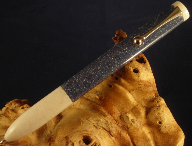

This is another Challenge pen , it is a Kitless slimline (longwood style) made from Storm blue and White Linen Corian .
I used 2 7mm tubes and a 7mm transmission which were bought in bulk , and a clip from Elliot (www.penmakers.com) , so no kits were broken up to make this pen .
The Corian is great for this kind of penmaking , it turns and drills well and shines like glass when done :glasses-cool:
I really like the way this one came out so I'm including it with the PITH pen I made for Nolan
Cool Butch I like that.Looks a little short.What is the length of the pen?Just curious.The Corian looks nice and the color contrast is nice also.Great work.:smile:

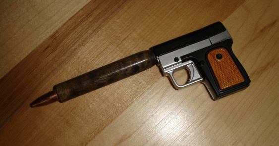

Awesome display of kitless slims! My computer broke for just over a week..as per Butch's request, here's the kitless pen transferred to here. It's a lighter, the gas and ignition removed, but the light still fully operational. Spun a barrel to simulate a silencer and died it ebony and a bullet exiting the silencer is the nib...so it's not just another typical bullet pen.

Jeff , I have to say that if this was a contest you would win for originality , that is a great concept and you pulled it off perfectly .
Thanks for posting it here .
:good::good::good:
It's not the most comfortable pen. It's comfy only in one position, with the trigger pointing down between your thumb and finger, so you can't just pick it up and write in any position, but it doesn't roll off the desk.

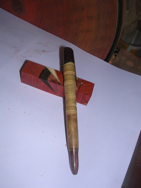

can you consider if these is a kitless pen.
it is made only with wood.
bocote with a spicy inlay next wood i don't know the name next sycamore and bocote.
i use only 2 x 7 mm tubes with a transmission and an old slimline clip.
Hi Kruger
Yep I would call that a Kitless pen and a very nice one at that . Wood is one of the harder materials to make kitless pens from but you did it .:good::good::good:

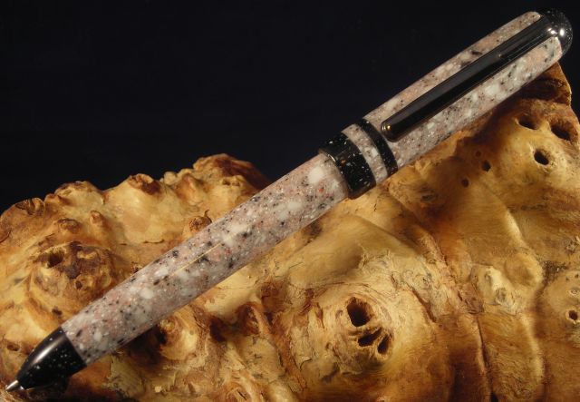

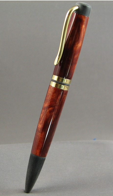

Kitless Euro (modified slimline)
Ok here's my next type of modification based on the lowly slimline .
This is a Kitless Euro/Designer pen . I used 2 7mm tubes and a slimline transmission that I buy in bulk (no kits were harmed during the making of this pen) and some Granite and Black Corian and a Mont Blanc style clip from Elliot at www.penmakers.com that I plated with Black chrome .
This one came out better then I had thought it would , almost looks like a kit pen :biggrin:
For my next trick , I will be making a 7mm Polaris style pen
