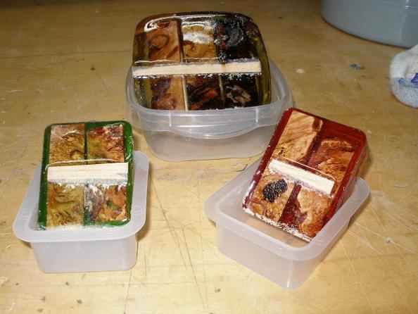

I had about 50 or so Eucalyptus Burl blanks which I obtained while on the job. I found the large burl on the side of a tree I was cutting down. The Euc burl is so punky and full of voids, it is impossible to turn without some sort of stabilization. I turned a hand full using CA. It was slow and used a lot of CA. Not to mention how messy it was. I used Curtis' Worthless Wood tutorial on one a few days ago and got very promising results. Of course, it needed improvement. There were still some very small voids inside the blank which showed up when I turned it. They were easy enough to fill with CA. Seeing real possibilities with the process, the other night I cast three molds of blanks. Two small molds with one each of red and green opaque PR. And one larger mold with a yellow PR, closer to amber.

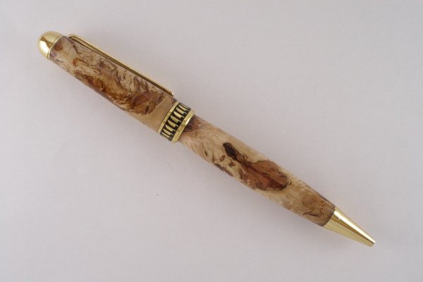

Tonight I tuned the red ones. I cut them to size, drilled them, glued in the tubes and mounted them on the lathe. They are being turned as Euro's. One of the most impressive things I have found, with the earlier blanks and these, is how easy they are to turn. I got very aggressive with these blanks. Even when bringing them to round. I wanted to test them, so I laid into them quite heavily. And I realize the ease in which they turn, will have to do with the way I mix my PR. Which is 3 drops per ounce, actually 8 drops for 3 ounces in the small molds. It is like the best of both worlds between wood and PR.
One thing I did notice is that once you get down to the finish, the wood and the PR react differently to the finish steps. I chose to put on some CA for a top coat. By the time I reached MM, some of the CA over the stubborn wood ares was thin. I just applied a couple more coats of CA and it was fine. I have had trouble with this wood since I first tried to use it. It absorbs the CA at different rates and that makes it difficult to get a consistent finish. This pen is still an experimental piece and it has a couple of very small holes in the finish.

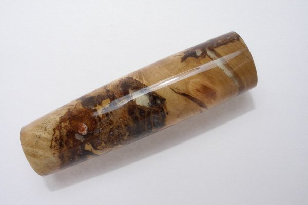

Here is a shot of the first blank I turned. It was to be a cigar. Look at the depth in which the PR penetrated, all the way to the tube. And this started out at least a 13/16 or better blank.
