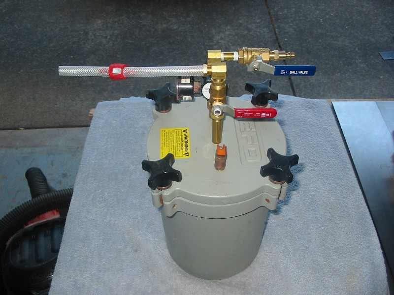

Here is my simple pressure only pot with notes to show what I did. I add a valve at the inlet and use the regulator for the pot. I do not like to leave mine hooked to the compressor like Don does since when I first started I did it that way and had the seal blow. It caused the compressor to run all night long and about burned it up. Parts of the compressor were so hot that it melted some of the plastic.

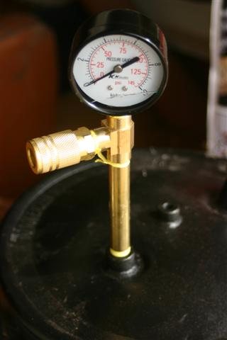

I use a guage that measures both. Here is a picture of my top. But, not the current combo guage.

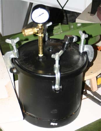

Ron,
Just do a simple search on "pressure pot" and you will see lots of designs. FirefighterEMT did a nice simple one a few weeks ago. Others have as well.
Cant remember who did this one,
Or like this one,
Do a search and you'll find pleanty.
Good luck and have fun.
Ok, dumb question time. What is the cutoff valve on the right hand side for? It appears that it's only cutting off an outlet in the fitting. If that's true couldn't you just plug the fitting? But there may be something I can't see in the picture. Or since I haven't cast yet, there may be something I don't understand.
The cutoff of the right side is to let the air out. For some reason the regulator will not allow the air to come back out the inlet with any velocity. It will leak out but very slowly! The other reason that I need the regulator on my pot is because I run a large compressor that is outside of the main shop and piped in. I use it for a lot of other things and need to have the pressure kept high and don't really feel like having to go out and reset it each time I use the pressure pot.
